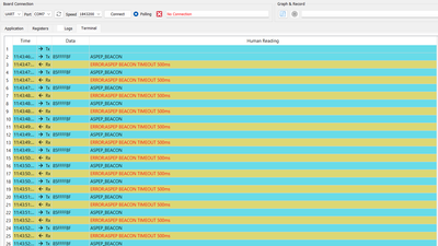

2026-03-02 1:55 AM
Hello @JulesC,
In the MC Pilot Logs tab, open the ST Motor Pilot.ini file shown at the line:
[INFO] - : ini file path=
In the ST Motor Pilot.ini file, set the following parameter:
TerminalVisible = true
Could you share the MC Pilot Terminal tab during the connection step?
2026-03-02 2:49 AM
Hello @GMA ,
Thank you for the instructions. I have updated the .ini file as requested. Here are the logs from the MC Pilot Terminal tab during the connection step:
Best regards,
Jules
2026-03-02 9:28 AM
Hello @JulesC,
MC Pilot sends a beacon message. Clicking on the ASPEP_BEACON message, MC Pilot displays the decoded message. The message is correctly decoded on the microcontroller unit (MCU) side. On the universal asynchronous receiver transmitter (UART) side, a BEACON response (0x05C70114) is sent, but MC Pilot does not receive it.
Check the USB cable and the STLINK-V3MINI. Try using another PC.
