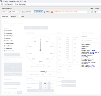

2026-02-09 1:29 AM
I am still unable to establish a connection to the STEVAL-PTOOL4A board via Motor Pilot, even though the motor is now functional.
Here is a summary of the steps I have verified:
Hardware Interface: Using an ST-LINK/V3MINI. Drivers and firmware are up to date.
Firmware Flash: The code flashes successfully onto the STEVAL-PTOOL4A board (I can toggle LED_ERROR).
Settings: * Baudrate: Set to 1,843,200 (default) in the firmware and matched in Motor Pilot. And the "Motor Profiler" option was enabled.
Since the UART communication for Motor Pilot doesn't seem to initialize despite these settings, could you please help me.
Best regards,
Jules
2026-02-09 3:17 AM
Update: I tried reinstalling everything like this post suggested:
https://community.st.com/t5/stm32-mcus-motor-control/b-g431b-esc1-mcsdk-motor-pilot-profiler-failed-connection/td-p/736072
I still can't use "Discover Board" and when I connect manually I still get this message: "Port Open and try to configure the board".

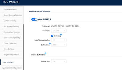

Hello @JulesC,
Are you using the default User Interface settings?
2026-02-10 5:56 AM
Hello @GMA,
Yes I use the default settings for all the MC Workbench project, I only changed the Motor and Power Supply settings, and added the "Motor Profiler" option.
Best regards,
Jules
2026-02-19 8:19 AM
I checked the UART pins on the board (J1). Using an oscilloscope at 1843200 baud, I captured the ASPEP handshake (Beacon packet):
UART1RX (Motor Pilot): 0x85FFFFBF
UART1TX (Board): 0x05C70114
The hardware link appears to be functional. However, it seems the capabilities in the board's response are being rejected by the software, preventing the transition to the ASPEP_CONFIGURED state.
