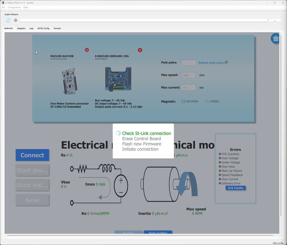

Same with B-G431B-ESC1 3Sh. Profiler 1.1.5 does not connect, however, Motor Pilot works fine.

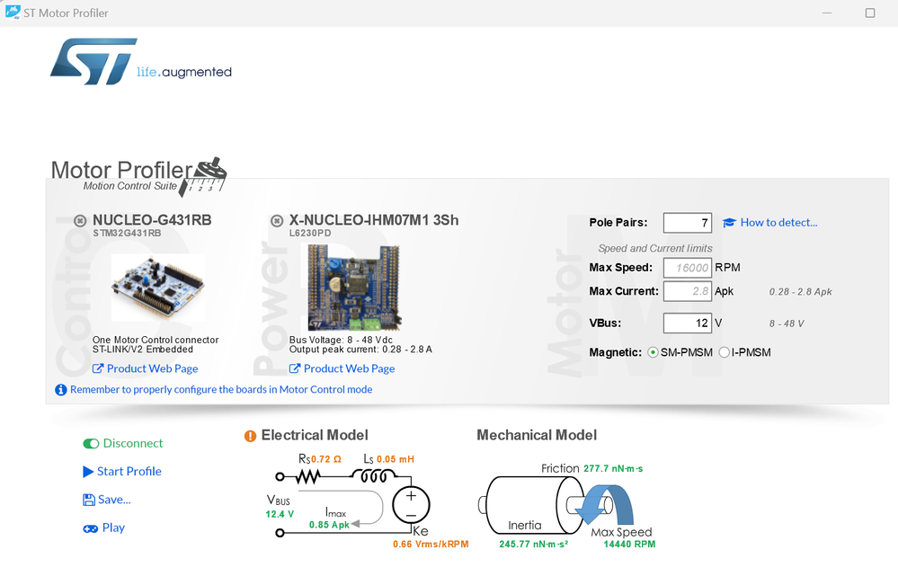

HI, I Try the same with Nucleo-G431RB & IHM07M1 with Motor Pilot 1.1.5 and do not work.
But if you use the older Motor pilot ( SDK 6.0.0 ) it will work.
I think that Motor Control SDK Team will fix it in the next Release only.

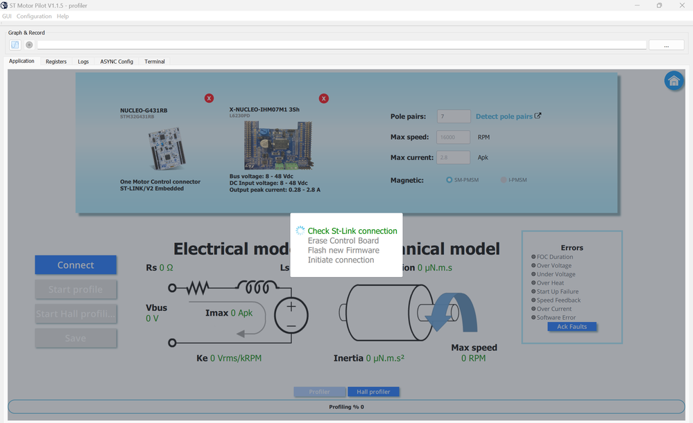

It seems that the motor profiler in some way communicate with the ST Link, because when i Start the STM32CubeProgrammer and connect to the ST-LINK, and thereafter start the ST Motor Pilot V1.1.5 profiler, I am getting the error message:
"No ST-Link Ready to use! Please check if ST-Link is not already used by other applications".

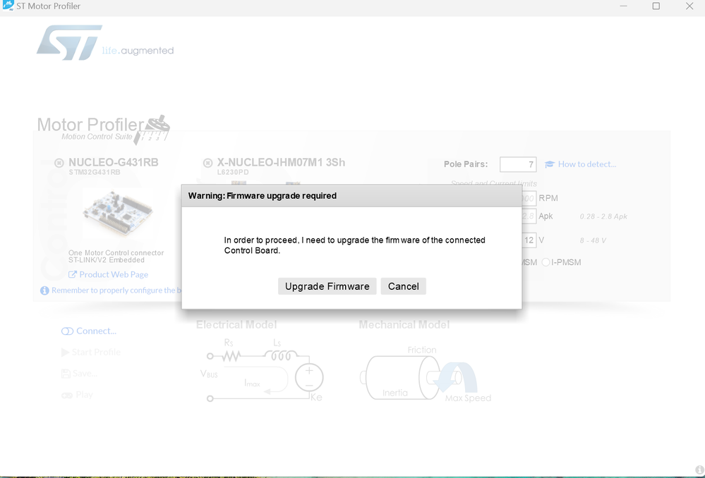

This is a correct message, because when I disconnect the ST-LINK form the STM32CubeProgrammer I am able to to connect but with a warning: Motor Profiler image required", when I then Accept to overwrite the current firmware, it just hangs (forever) on the message "Check St-Link connection"
