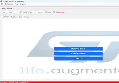

I am working on a custom board with STSPIN32F0601S3, after generating code using MCSDK Version 6.3.0 with cube Mx 6.10.0, I tried to connect Motor pilot just start/stop and change RPM but it did not connect, Pls confirm which steps I am missing
Below are the steps I followed but still it did not connect
1.Uploaded and RUN code (using cube ide)
2. RESET board
3. Opened workbench and selected Motor Pilot
but it leads to default App Mode (pls refer screenshot) not detecting firmware although code is in run mode and not able to use Motor pilot which was along with MCSDK Pack 6.3.0

" No ST-Link VCP detected"
But I am using Custom Board with USB To UART Converter, Do It is needed to click on discover board, it should redirect automatically to Motor Pilot after connecting UART and code, why this default App pops up, not Linking with FW although code is in RUN Mode.

Hello @Nidhi12,
The "Discover board" feature in Motor Pilot tool is available only when using an STLINK connection.
For other use cases, the user must load the associated QML file and manually select the COM port.
