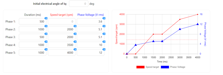

Recently through debugging the uart issue was solved in custom board and i was able to connect to motor pilot, but found the issue that it was starting with undervoltage, getting error like speed feedback error and overcurrent error although there was no load in motor after pressing the reset 2-3 times the motor was running smoothly.
I need help in software part as below
1) how to set the parameters in motor controller because i have tried, but as i have set under voltage at 9V and giving the supply of 12V then also it is showing undervoltage, setting the speed confiuration in sensorless startup as shown in the image it is not properly set and not getting how to calculate the parameters.
2)I have set the parameter for overcurrent to 50A but then also it showing error when motor is under no load.
3)In the code how to add such that if the the input supply current is greater than X A then the motor controller should top and for any other error it should wait for 15sec and then clear the error and again try to run the motor.
sir don't suggest some file or API like mc_api and all because previously also getting the same response and the problem is not solved Give a code snippet to add and solve the problem
