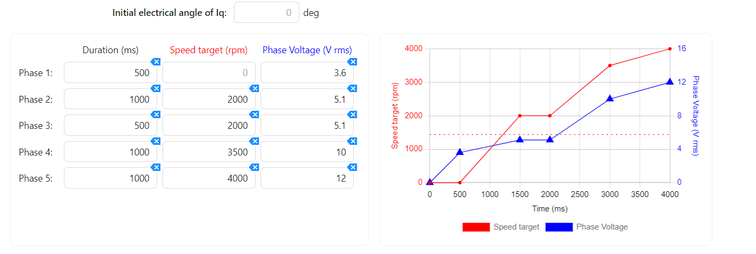

Recently through debugging the uart issue was solved in custom board and i was able to connect to motor pilot, but found the issue that it was starting with undervoltage, getting error like speed feedback error and overcurrent error although there was no load in motor after pressing the reset 2-3 times the motor was running smoothly.
I need help in software part as below
1) how to set the parameters in motor controller because i have tried, but as i have set under voltage at 9V and giving the supply of 12V then also it is showing undervoltage, setting the speed configuration in sensorless startup as shown in the image it is not properly set and not getting how to calculate the parameters.
