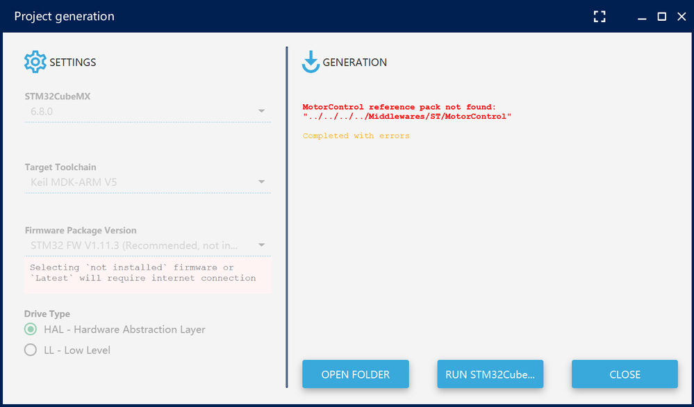

2023-06-05 9:15 PM
Hi @Zied b. ,
I too have a similar problem but with mCSDK version 6.1.2 and tried using STcube MX 6.4.0, all the include and source files are generated but showing an error "completed with errors".
can you suggest what need to be done?
thank you
Vijay

2023-06-06 2:00 AM
Hello, according to your screenshot it seems that you are not using the correct version of the MCSDK, it is not version 6.1.2, can you try again with the correct version?
THANKS

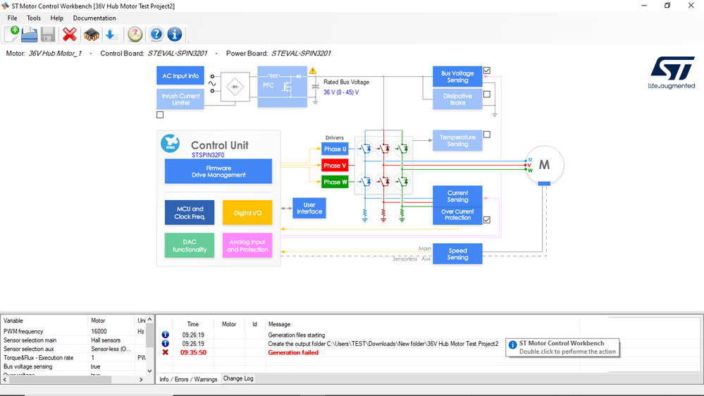

2023-06-06 2:27 AM - edited 2023-11-20 9:07 AM
Hi Zied b.
Tried with MCSDK 6.1.2 and 5.4.8 but every version is having same issues. Not able to generate the project successfuly.
Please do check and help us in resolving the issue.
thank you
vijay G

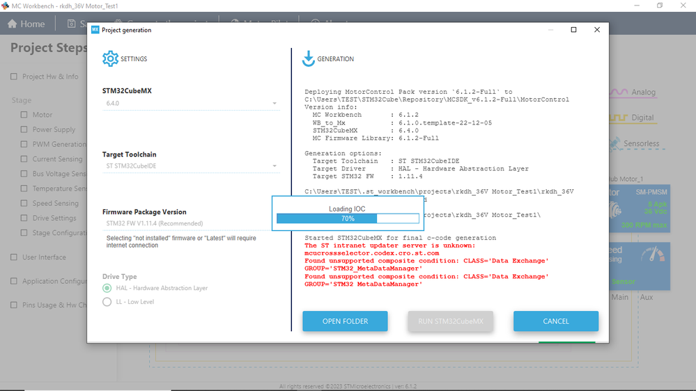

2023-06-06 2:38 AM
can you try MCSDK version 6.1.2 with cube mx 6.8.0?
2023-06-06 2:40 AM
Yes tried the latest version and then saw the suggestion here and tried version 6.4.0 cubemx.
I will try again with all the latest versions and send you the screenshot whether its working or not?
Thank you
2023-06-06 2:59 AM
yes of course, I would be happy to help you
