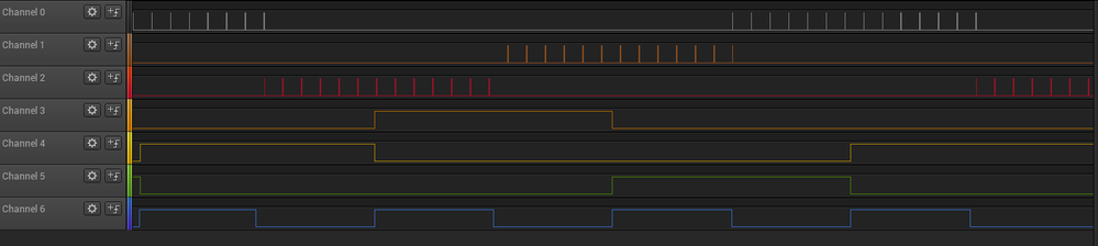

Hello - i'm new to STM32 MCU's (mostly have been using 8bit AVR's or OS based Raspberry Pi). I've been trying to implement a 6-step motor control (making everything from scratch as a learning experience). I picked TIM4 and TIM8 in a master-slave configuration, using complementary outputs of channel 1, 2 & 3 in TIM8. Everything is set so that PWM preloaded registers update happens in a commutation even, which is the TRGO of TIM4.

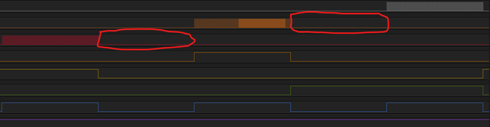

}The problem i'm experiencing, is that between steps using the same "high-side" PWM, the output goes low after changing the low side - for example:
going from step 2 to step 3, the PWM is correctly genrated on CH3 during step 2, but the outpul stays in the low state during step 3.
Funny thing is if i do a breakpoint in the callback and use the debug as a "step mode" the pwm is generated properly. Maybe anybody experienced something similar in the past?

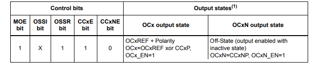

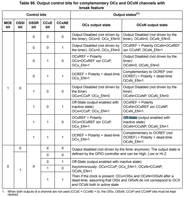

2022-08-10 11:54 PM
I got it to work - most of the issues were coming from turning off both the CCx and CCxN channels:
If you set both to 0 (both OSSR and OSSI are '1' in my case), then both channels are no longer driven by timer - that caused issues when i just turned it back on. I opted for the option of disabling only CCxN and setting CCR registers to '0'.

2022-08-08 6:54 AM
Maybe you should not mix Cube/HAL and register access.
> Everything is set so that PWM preloaded registers update happens in a commutation event
Only the CCxE, CCxNE, CCxP, CCxNP and OCxM bits are loaded upon COM event (if TIMx_CR2.CCPC is set). The TIMx_CCRx registers, if preloaded (OCxPE set), are not loaded upon COM event but upon Update event.
> TIM8->CCER = 0UL | ( TIM_CCER_CC3E | (TIM_CCER_CC1E) | (TIM_CCER_CC1E) )
This does not seem to be correct.
