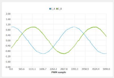

Ia and Ib currents are current phases from your motor, they should look like that :
If you have absolutely no current on one phase, then yes, it means you have a HW issue, because nothing is received from the motor, even in Open Loop.

The image you have shown is of Open Loop or Closed Loop?

The picture was taken with an Open Loop setup, however you would expect the same behavior from a Closed Loop.
