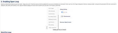

And concerning the User Manual of the MCSDK, which contains a "How to use the Open Loop mode", I am referring to the one you can find via WorkBench by clicking on About -> Documentations -> Documentation -> in the newly open browser window, click on User Manual. Then click on Open loop description and usage.

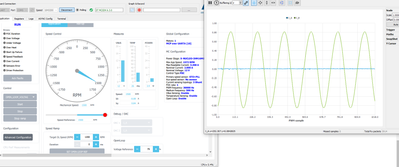

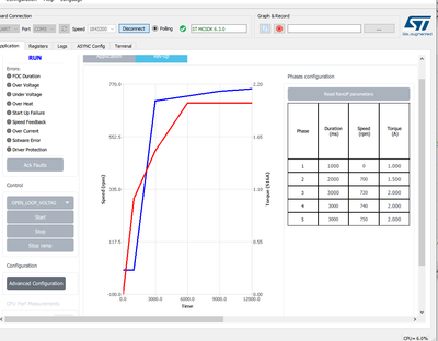

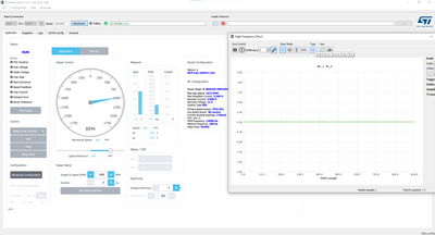

Open Loop Voltage Mode Ia and Ib Motor state is "RUN" but its not spinning.

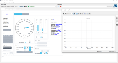

Open Loop Current Mode, Ia and Ib, same thing happening:
Parameters:
What does this open loop result shows?

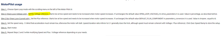

Hello tejas_amp,
For the usage of the Open Loop mode, please read thoroughly the dedicated entry in the MCSDK User Manual.

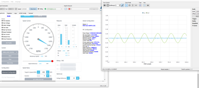

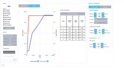

Hi, I have read & followed the documentation properly this time. Next time will make sure, this don't get repeat.

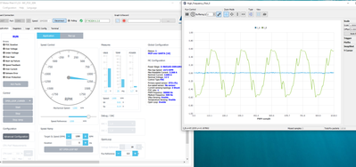

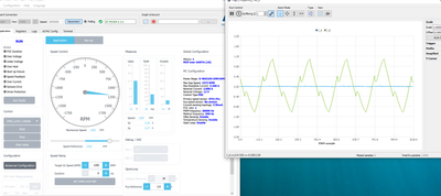

Below are the results of "Open Loop" Voltages and Currents by varying Vref and Fluxref parameters as speed of motor increases. I have varied them from V: 10 to 80 and Flux: 0.5 to 2 A. The motor state is showing "RUN" but motor is still and producing noise Please suggest further.
Parameters:
Parameters
OL_Voltage:
OL_Current:
