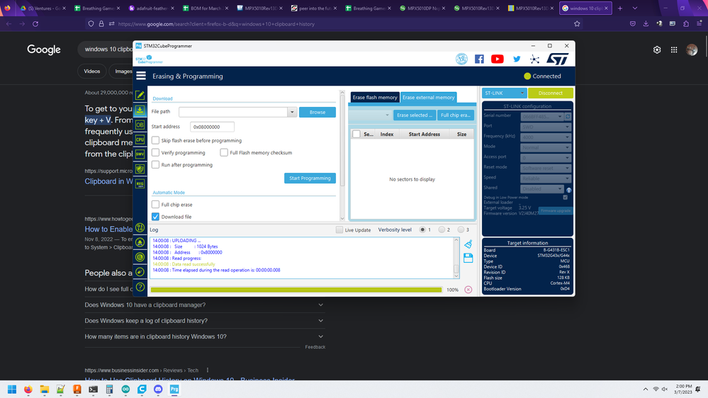

sorry here it is

Hello ,
Everything seems to be correct with your board,
can you get the file "B-G431B-ESC1#B-G431B-ESC1 3Sh#(6.1.1).hex" which is in the directory : \MC_SDK_6.1.1\Utilities\PC_SoftwareSTMotorPilotSTM32CubeProgrammer\Fw and flash it manually with Stm32CubeProgrammer then try to connect manually with the profiler.
If you have the possibility to make a video screen capture so that I can understand where the problem comes from?
thank you
