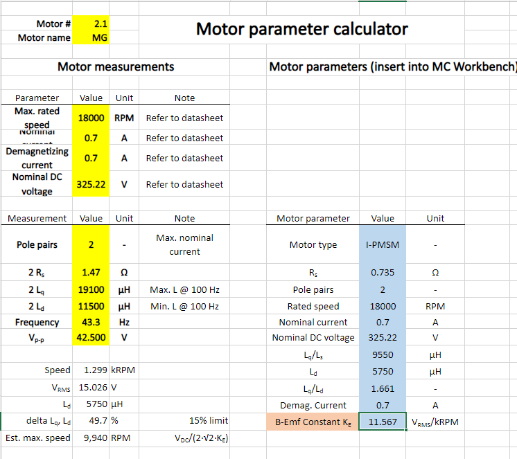

Thanks for the info, attached the motor specs.

How much current are you measuring when reaching 15000rpm?
2023-03-09 8:50 PM
Less than 1.2A in the motor phase when measured in AC Fluke clamp meter.
I have tuned the current regulator PI values by using the step function in the monitor.
And after a few minutes of continuous running(no parameter changed), the motor stalls and gives a speed feedback error in the monitor.
