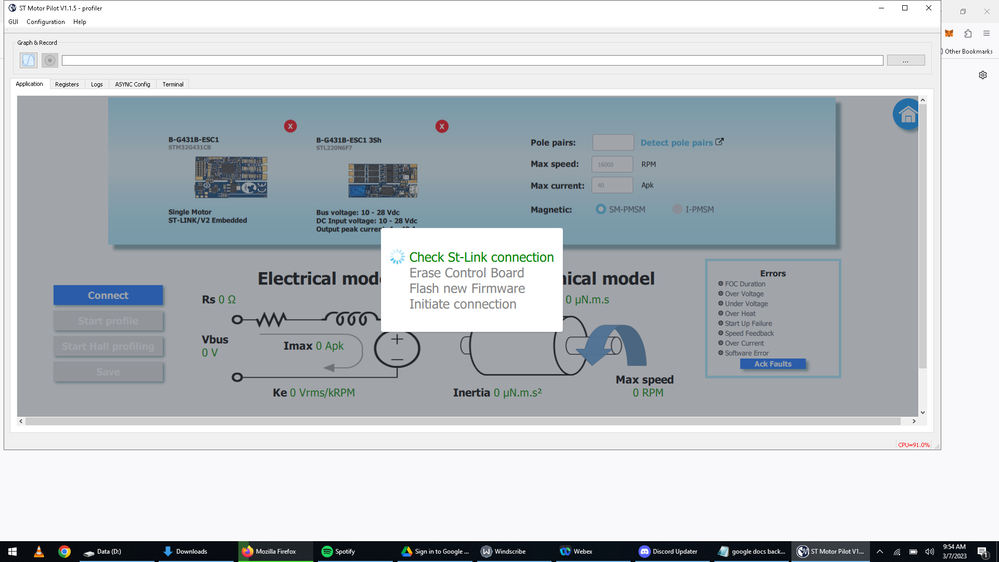

2023-03-07 7:01 AM
The version 6.1.1 of the motor control workbench and the motor profiler included in it hangs at the stage where the profiler is trying to connect to the board. The board and everything else works, I am able to program the board using Arduino.
This is where it hangs.
So, to be clear, there are two different errors. This is the one that occurs with version 6.1.1 of the sdk. I had that problem before and tried to uninstall it and install 6.1.0. That was able to flash the firmware once, but then it gave the error thereafter that is discussed above, where it said the MCU was not supported.
