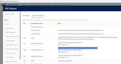

Hello @kumarairia,
You have to add an external wire between PB14 and PD14, as mentioned in the Workbench Pins Usage & Hardware Changes tab, which is not visible on slide 6.
2025-09-12 3:56 AM
PB14 and PD14 are connected on the back side, I have soldered wire there. Once I am at work I can send you picture.
