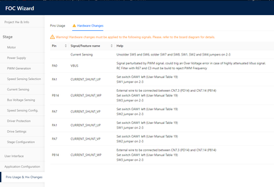

Hello @kumarairia,
Did you check the list of hardware updates to be done on both boards? A list is available on workbench interface
Refer to steval-ipmnm2s user manual (Chapter 6. Current sensing amplifying network) and stm32303e-eval user manual (Table 19. Motor control related switches and solder bridges in OAM position).

Hello Expert,
Yes, I have carefully checked, and all instructions have been followed. Still facing same issues.
