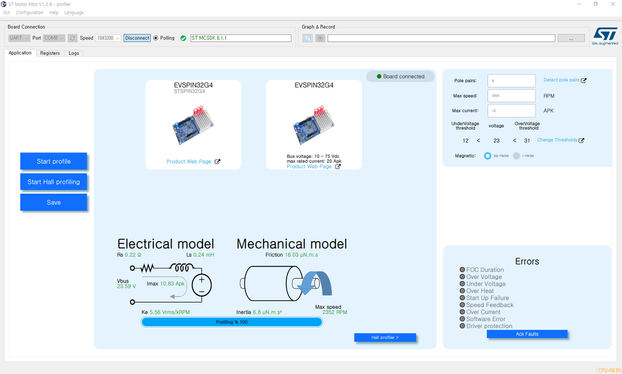

I had the motor profiling experience to get motor mechanical and electrical parameters using EVSPIN32G4 boards
as following:
Now I'm trying to start the project for controlling a new high power motor with EVLSERVO1 board.

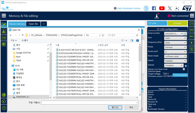

But, I couldn't find the ST provided firmware for EVLSERVO1 board as listed this.
I'm wondering the EVSPIN32G4 firmware is compatible with EVLSERVO1.
Thank you for your any advice.
