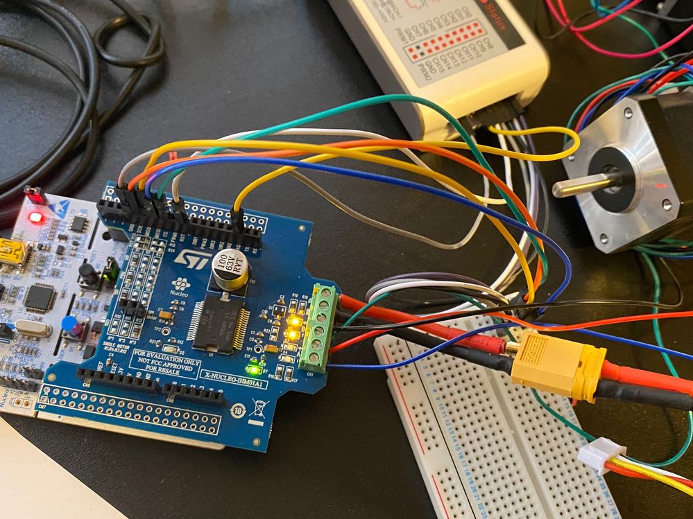

I have connected various stepper motors to multiple x-nucleo-ihm01a1 shields on a NUCLEO F466RE.
The code is the same as ST's X-CUBE-SPN1 (i just changed the function names) In main() after SPI has been initiliazited at 2MHz at mode 3, I set the registers to their init settings ( begin() ) then attempt to move the motor forward 16000 steps.

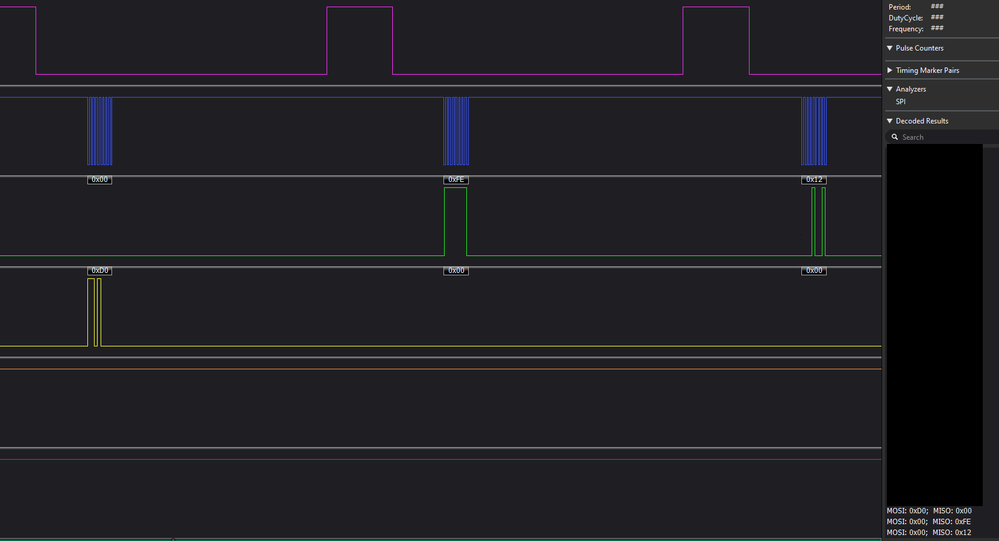

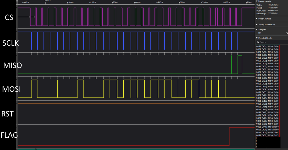

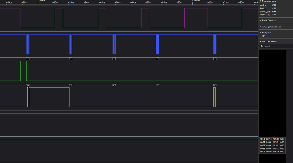

The SPI communication is working as the waveforms show the right commands (commands in hex on the right side of screen). (Pic 3 is init , pic 2 is move 16000 steps, pic 1 is get status .... pics are in reverse order.
The motor gets powered but is stuck and doesnt move and the program gets stuck forever at the WaitWhileActive() command. On sending the getstatus command, none of the error flags are triggered and HiZ is low as desired. Everything looks good unless i've missed something, why doesnt the motor move?
