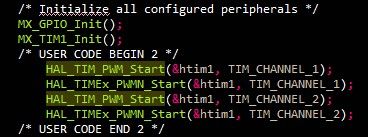

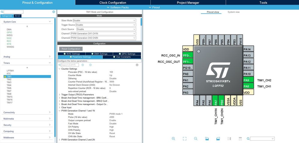

I'm using TIM1 pwm generation ch1 ch1n & ch2 ch2n. My deadtime is set to 200. It's running at 100Hz and %50 duty cycle. I set the parameters as it should but nothing is working. My channel 1 & channel 2 settings are the same. Can someone help me to do it?
Thank you.
