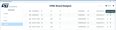

For the moment, Board Designer tool does not handle internal connected pins.
Can you try to create your custom inverter board from a duplication of the EVSPIN32G4 board?

You can edit it. STMC Board Manager tool could help.
