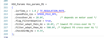

Hi, I have been working with the HSO motor control algorithm using Motor Workbench 6.2.0. I was able to successfully configure the firmware for a custom PCB, and it works correctly. The motor, which is a PMSM with 2 pole pairs, starts and runs without any issues up to 30,000 RPM using the HSO's speed mode.
However, as I increase the bearing friction to test the maximum load at which the motor can still start, I notice that no matter how much I increase the application's maximum current, it is not applied right from the beginning by the algorithm in situations where the motor is unable to mechanically move the shaft.
Specifically, I observe that from the start and for about 700ms, the algorithm applies a current equivalent to 70% of the maximum application current, and even though the shaft doesn’t move, the algorithm’s estimated speed increases linearly up to 3,000 RPM.
In this regard, after reviewing the configuration parameters in the firmware, I am wondering how the following are calculated:

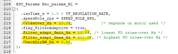

SPEED_POLE_RPS doesn’t seem to change as I edit the motor parameters in Motor Workbench. Which parameters is it based on?
Regarding CrossOver_Hz, the comment indicates that it depends on the motor used, but I don’t see it change even when I modify motor settings in Motor Workbench.
The fact that the estimated speed from the HSO increases while the shaft remains stationary could be a sign that the algorithm’s observer is not properly tuned. In that case, how would it be necessary to adjust the other parameters marked in the previous image?

[VERSION]: Version of MCSDK 6.3.1
[TOOL]: MC workbench , ST MOTOR Pilot
I encountered the same problem mentioned above. After modifying the motor parameters using MC Workbench and generating new code, when I compared the new code with the old one, I found that the parameter configuration for the structure named Hso_params_M1 does not change according to the motor configuration parameters. However, the comments within this structure state that this parameter needs to be adjusted based on the motor. Could you please explain in general how this adjustment should be made?

Hello propu,
CrossOver_Hz is a parameter that does not need to be changed by the user. Only the maximum and minimum values are useful to tune, but the default ones are already sufficient for the large majority of use cases. It is true that the code documentation is confusing, thank you for your feedback.

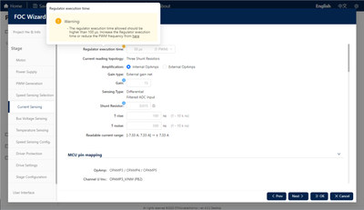

In the MC Workbench 6.3.2, the "Regulator execution time" prompt suggests that it should be greater than 100us. I don't quite understand this. I have tested that the high-frequency task time is about 30us, which means the PWM frequency should be able to reach 33kHz, performing one algorithm calculation per PWM cycle. However, if the regulator execution time needs to be greater than 100us, this implies that the algorithm calculation frequency should be less than 10,000Hz. Would this have a significant impact on the bandwidth of the current loop? I would like to ask, what is the maximum frequency at which the HSO algorithm can reliably operate in practice?

The WorkBench value is purely indicative, you can try with lower periods and see how it goes. We have no definite known speed at which the HSO is not able to keep up anymore.

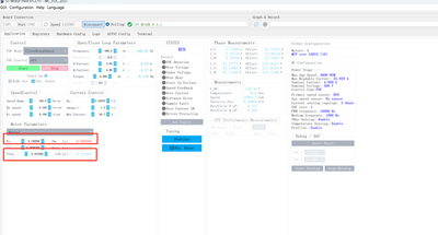

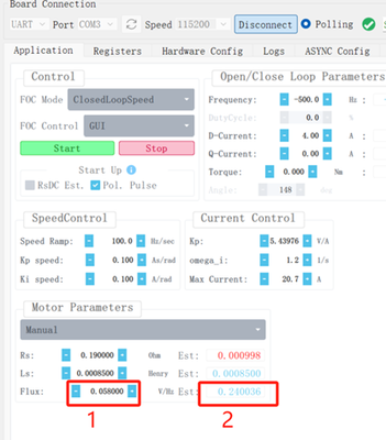

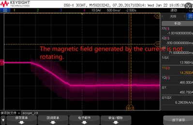

In the image below, the measured resistance Rs of the motor by RLC device at the position marked by the red box is 0.19 ohms. When I directly set the value to 0.19 ohms in the code and use the default Pol.pulse method, the motor has a very high chance of not rotating. However, when I manually set Rs to 0.16 ohms, I found that the motor has never failed to turn。

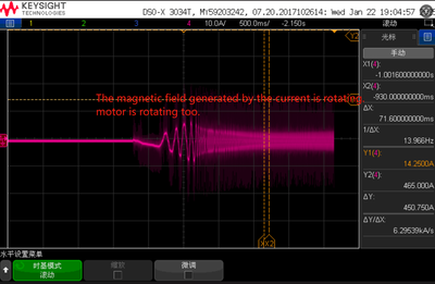

Comparing the current waveform on the oscilloscope, the image below shows the current waveform of the motor with a resistance of 0.19 ohms when the startup fails. The current stabilizes in one direction and does not generate a rotating magnetic field。

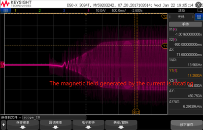

When I reduced the resistance to 0.001 ohms, I found that the output motor current was always rotating, and its amplitude kept increasing. The motor did not rotate. I understand that the increasing amplitude is due to the speed control loop, which controls the speed, and the output Q-axis current is continuously increasing。
When I tried setting the D-axis current to 4A while still using a resistance of 0.001 ohms, the motor could be dragged up and successfully performed the closed-speed-loop control。

As propu described, in MC Workbench 6.3.2, the "Regulator execution time" prompt suggests it should be greater than 105 µs with 4 PWM for my project at FPWM = 38 kHz.
If I reduce it to 1 PWM, I get an FOC duration fault.
