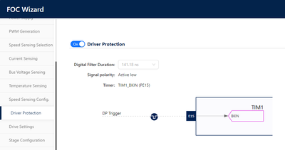

Did you enable the Driver Protection feature to report errors from the STSPIN32G4 device?
If you agree with the answer, please accept it by clicking on 'Accept as solution'.
Best regards.
GMA
You mean the undervoltage and overcurrent protection in the driver section? It is enabled by default in the program, and I haven’t changed it. I read the status register and no protection had been triggered. Also, I found that when setting the register, only setting VCC_VAL and changing the voltage to a value other than 8V will cause the entire system to power off and trigger undervoltage protection. I’d like to ask for your advice. Thank you.
