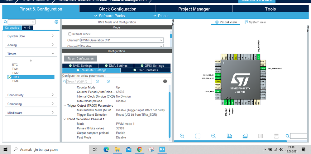

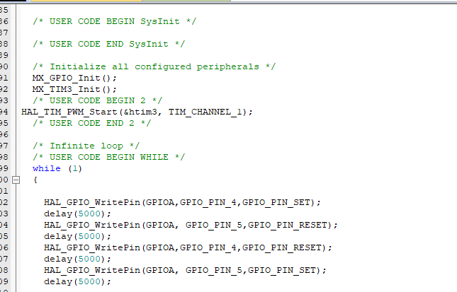

Hi everyone, I'm trying to drive linear motor with l298n motor driver. I use CubeMX to set pinouts and keil to code. I have to generate pwm but I think I couldn't calculate it correctly. Can anyone help me?

You can refer to the example located under \Projects\STM3210E_EVAL\Examples\TIM\TIM_PWMOutput for PWM generation in STM32F1 Cube.
But be careful you should ensure minimum 2.3V as high level to drive L298N (refer to its datasheet: Input High Voltage min).

thank youu, I handled it
