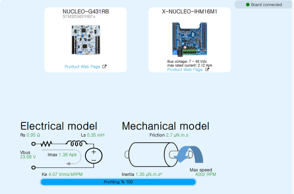

However, when measuring the same motor using ST Profiler to obtain the Electrical Model and Mechanical Model, the result showed Imax = 1.38 Apk.
Please note that:
The actual motor drive board is EVSPIN32G4-DUAL.
ST Profiler does not support EVSPIN32G4-DUAL, so the Electrical and Mechanical Models were measured using X-NUCLEO-IHM16M1 instead.

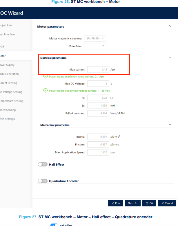

The profiled maximum current (Imax) is 1.38 A. Why is 0.15 A mentioned on the WB interface?

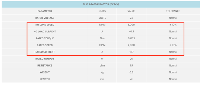

The BL42S-24026N (26 W) motor documentation specifies a rated current of less than 1.7 A and a power rating of 26 W. Exceeding these values is not recommended.

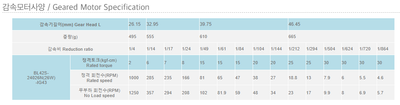

The motor documentation also provides a torque table:
