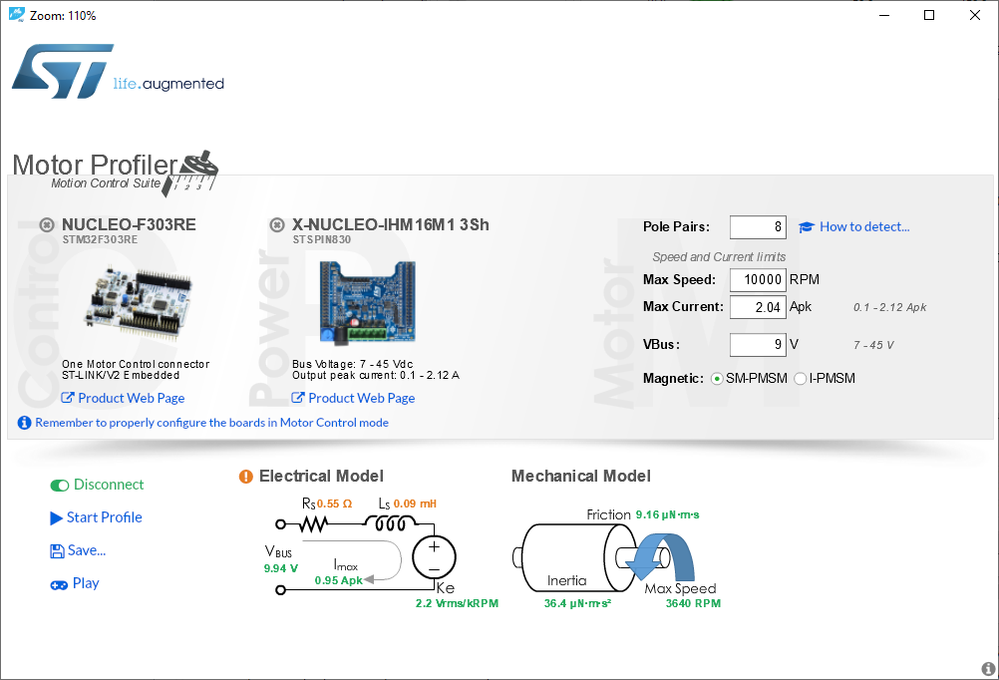

There are some hints already in the profiler, of something not being optimal, but my basic understanding of this technology is not enough to tell whether this could be a reason for the "sometimes works" problem:
The profiler notes that things are "optimized for" Rs > 1Ohm and Ls > 1mH. According to the datasheet, the former should be satisfied with the given 1.01Ohm, but the latter not, with only 0.32. But the profiled values are very off from that, giving 0.55Ohm and 0.09mH.
It's the 200188 here: https://www.maxongroup.com/medias/sys_master/root/8882562793502/EN-21-294.pdf

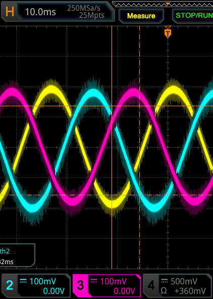

The winding's seem OK in so far as, connecting a star with three 100R resistors and looking at the voltages across the resistors with the oscilloscope (with nothing else than the resistors & scope connected to the motor for this test), I get 3 sine curves as expected (see image).

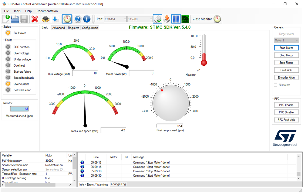

Edit: when I try to start everything new, with the motor speed set to moderate reverse speed, the MCWB shows it trying going from idle to unknown, then the speed needle going negative, but to 3000 instead of just the set 1000 on the dial, while the motor actually stands still but makes some slight noises. Then, MCWB will show over current (see MCWB screenshot)

(yellow is the phase-1 here, cyan is 2, purple is 3 - looks in order, not connected to the board while scope'ing this, but still on the detachable, green plastic block 3-pin connector of the IHM16m1 board.)

In Workbench, I am getting overcurrent error when fiddling with the speed dial, esp. from faster to slower speed, perhaps also due to some back-EMF thing. But it's much less likely, even for larger intervals, if I enter numbers for speeds, e.g. 3500 to 500 (as opposed to turning the dial).
