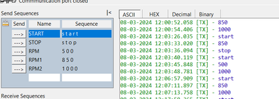

Start and stop commands are working properly, when it comes to sending 4 digit numeric value through uart, it is taking as 3 digit number

1. commands are being send and received correctly.
2. I also tried stepping the receive code, characters are receiving properly
Yes i did typo mistake in title, That's not bit , that's 4-digit
