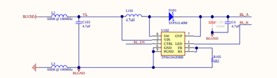

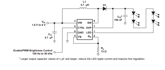

from circuit https://www.st.com/resource/en/schematic_pack/mb1860-rk050hr18c-b01-schematic.pdf
So any PWM with 100...10k Hz should work fine.
So set for example PSC 40 , ARR 3000 ; should give good range (but our eyes not linear, so 50% pwm is not "half brightness" )

2026-01-16 7:21 AM
Maybe there is a RC filter to prevent spikes giving a flashlight effect (i would do it and put a RC filter in).
So I suggested a medium frequency setting, good over the visible flicker (< 50Hz), but not too high.
Or you have to set the ch2n pin to higher pin speed...anyway, to know how the signal looks, you have to use a scope to see it. And check ds of the TPSxx , what its doing when light "modulation" is in xx kHz range.
