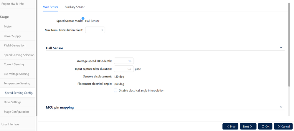

I have used profiler to get the hall sensor parameters. I have put the same parameters.

Yes I used Motor Hall Sensor profiler.
Is there any starting issue. In sensor less control the operation is smooth. But in hall sensor as speed feedback the motor doesn't even rotate a single turn and speed feedback issue comes.
I tries to tune it also but its having no effect. Even if i give extreme values of PI gains, its having no effect.I think its just a small detail which is missing.

I am using ST MC workbench 6.3.0, is it anything to do with version ??
