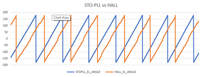

2024-11-19 12:04 AM
Hello @GMA.
We have verified phases U, V, W and Hall Sensors H1, H2, H3 are correctly connected. We did check hall Signal output while spinning it by hand and found them to be correct according to the requisites mentioned in this documentation (Launch Workbench 6.1.2 -> About -> Documentations -> User Manual -> Hall sensor feedback processing). Refer image "Phase Bemf vs Hall 1" (in previous post). The Yellow waveform represents Phase U and Red waveform represents Hall 1 signal outputs.
We proceeded with generating a project with STO-PLL as the main and Hall sensor being the auxillary sensor as you suggested. The graph generated using Motor Pilot "Graph & Record" is displayed below.

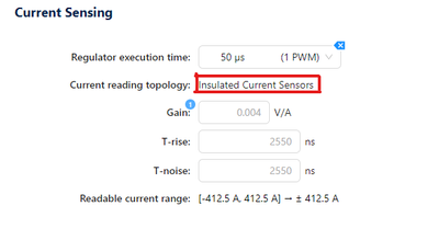

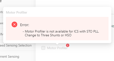

But to configure and run the motor pilot HALL profiler, the workbench doesn't show any option to change the current sensing topology to 'Three shunt resistor mode' from Insulated Current Sensors.
What are we missing?
2024-11-19 2:34 AM
Hello @AkhilDP,
According to the electrical angle graph, HALL sensor signals are not connected as expected: angle is increasing for STO-PLL and decreasing for HALL sensor then it means that HALL does not report the same rotation direction.
Motor Profiler tool does not support ICS Curernt sensing topology.

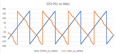

2024-11-20 11:34 PM
Hello @GMA ,
Did a few trials and upon changing the Hall Sensor sequence and repeating the same exercise and below is the graph attached.
This is reporting the same rotation direction.
Also, agreed that Motor Profiler tool doesn't support ICS topology. The Workbench itself doesn't have that drop-down to select Shunt while we followed the steps as you suggested (5.2.5. Start Hall sensor profiling" chapter in STM32 MC Motor Pilot Start-up guide). Now, what is the solution to this? Are there any workarounds?
Just so you, know we are using STEVAL-CTM009V1 kit of which the Power Board is STEVAL-CTM004V1. This is enabled with Shunt as per the datasheet and schematics.

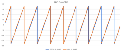

2024-11-22 5:36 AM
Hello @GMA,
Now by mentioning the variable "HALL_PHASE_SHIFT" is nothing but "Placement electrical angle" as mentioned in Workbench.
Anyways, we did implement your approach into getting the STO-PLL and Hall EL angles to coincide by changing the value of "HALL_PHASE_SHIFT" in "pmsm_motor_parameters.h" and upon tuning below is the graph we obtained. Please note, 124° is the value at which these two waveforms coincided. We incorporated this value into the code using HALL Mode as main sensor alone. But the motor didn't budge.
Few Observations:
The Phase firing sequences were observed on the scope in Sensorless mode but the during Hall Sensor mode the waveforms showed no firing sequence or modulation in the PWM same as images "PWM-Sensorless" and "PWM-Sensored" for sensorless and Hall Sensor Mode respectively in my second post.
