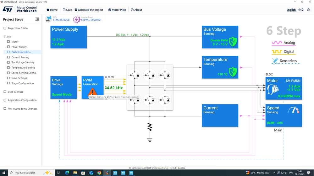

I too have this issue. I'm using the steval-esc001v1 and my custom motor parameters are attached below. For the given hardware and motor, I have generated the code in MC_workbench version 6.4.1.
I'm getting the following error,
Does this error will affect the hardware or motor, if the code is dumped to the esc.
Kindly help me with this.

2026-01-07 1:08 AM
Hi @santhosh16
the overcurrent detection is not natively supported in the code for this board.
However the hardware allows the user to enable it and configurate it. COMP2, COMP4 and COMP6 are the internal comparators that are connected to shunt signals and can be used for this purpose, VREF is the reference threshold.
Regards
