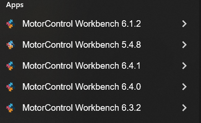

Thank you for the reply, @GMA. I did not modify any project files; however, there are multiple versions installed on my computer (as listed in the attached image).
Hello @Raj6135,
Does MCSDK_v6.4.2-Full folder present in ~/STM32Cube/Repository? If not, uninstall and reinstall MCSDK6.4.2.
Generate a new project (do not use a previously use directory).
Generated .ioc file should contain "ExtraMW.MotorControl.Root=MCSDK_v6.4.2-Full/MotorControl".
STM32CubeMX v6.17.0 is recommended for MCSDK6.4.2 (refer to MCSDK release note for more details).
If you agree with the answer, please accept it by clicking on 'Accept as solution'.
