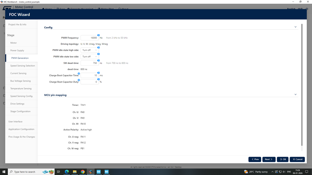

2026-01-06 2:00 AM - edited 2026-01-06 10:44 PM
Hi @cedric H ,
I have used st motor control workbench version 6.4.1, cubeMX version 6.15 cube ide version 1.19. In Motor control workbench i have selected steval_esc001v1 and motor as bldc.txt file (attached below). Now i kept all the settings of the project as default. In which driver settings shows as 16Khz as pwm frequency.
so, I have given the pwm input as 62.5us time period and 10 to 90% duty cycle and i got no response from the motor movement. So is the pwm should be 800us in my case too, or how to calibrate for my esc.
