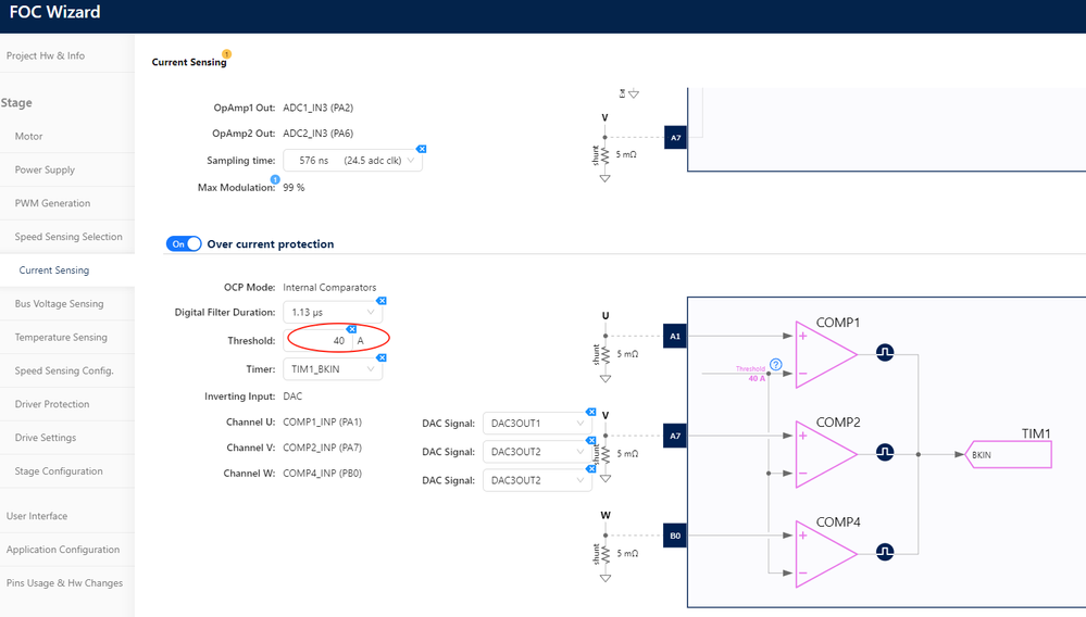

I have an EVSPIN32G4 evaluation board with a sampling resistor of 0.005Ω.
Why does a current of 40A correspond to a threshold of 7427 (0.37V)?

Hello @Garey,
Did you review the "5.5.2 Embedded comparators" section of the EVSPIN32G4 user manual?

Hello @Garey,

Hi GMA,
I think I understand now, thank you.
(VDAC - 0.198 V) * 227 A/V
