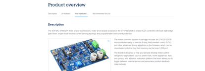

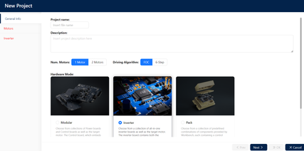

We want to run BLDC motor using STEVAL-SPIN3204, As per user guide initially we started with motor control work bench 6.3 version. while creating new project selecting driving algorithm as FOC and selecting the motor type but in inverter section STEVAL-SPIN3204 this board is not available , it is available when we select driving algorithm as 6 step.
As per product specification on STM website it says it support both FOC and six step.
for reference refer below snapshot.
kindly confirm can this board be used as in FOC and six step mode. Is that motor control work bench is not supported FOC for this board.

It is wrong comment from our side, and we are deeply sorry for this inconvenience. A request will be done to change it.
STEVAL-SPIN3204 board only supports six step mode.
