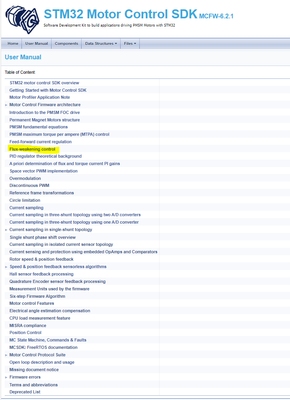

Hello @Akhilesh30 ,
You can find the description of flux weakening in the user manual :
From what I saw in your screenshot, your motor reaches the max application speed.
If you want to go beyond this speed, then you have to increase the max application speed parameter from the motor configuration panel of the MC Workbench. At least you will have the ability to increase the target speed in the Pilot tool.
