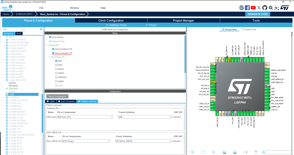

I'm experiencing an issue with USBX Host implementation on STM32H573RIT6 where disconnect events stop working after enabling Host Controllers FS in CubeMX.
Problem Description
Environment:
MCU: STM32H573RIT6 (Custom board)
Middleware: Azure RTOS USBX + FileX (MSC Host)
VBUS: External constant 5V supply (no USBPD/VBUS sensing used)
Connection detection: DP pin based
CubeMX: UX Host FS + Host Controllers FS enabled
HAL setting: hhcd_USB_DRD_FS.Init.vbus_sensing_enable = DISABLE

Hi, Thank you for the guidance. To answer your question regarding the application code, I used the settings from the official CubeH5 Host MSC example as a reference and starting point. However, since my custom hardware does not use USBPD (USB Power Delivery), I have completely removed all UCPD-related configurations from the setup.
Additionally, I have commented out the HAL_HCD_Connect_Callback and HAL_HCD_Disconnect_Callback that I had temporarily created for debugging. I can confirm that these callbacks are now properly handled by ux_hcd_stm32_callback.c.
However, as I look deeper into the generated code, I noticed the usbx_stm32_host_controllers folder. I strongly suspect that the source code within this folder might be performing VBUS-related checks or control internally.
Since my hardware design does not use VBUS sensing (5V is constantly supplied to the port, and I have set vbus_sensing_enable = DISABLE), I suspect this internal USBX controller code might be conflicting with my setup by expecting a VBUS signal state that will never toggle.
Could you please share your thoughts on whether this suspicion is reasonable? If it is, how should I modify or configure the files within usbx_stm32_host_controllers (or the USBX stack in general) to completely bypass these internal VBUS checks and rely solely on the DP/DM data lines for the connection state?
