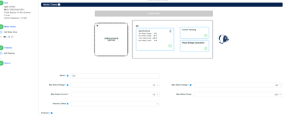

The following images show my configuration process:

Hello @一hang.,
Can you share your board description .json file?

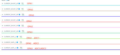

2025-08-25 6:18 AM - edited 2025-08-25 6:19 AM
Hello @一hang,
For the current MCSDK implementation, only ThreeShunt_RawCurrents_Differential_ExternalGain_FilteredADCInput is supported on the STM32G4 series.
The description of the current sensing feature is available here.
2025-08-26 2:49 AM
2025-08-28 1:22 AM
Hello @一hang,
As the ThreeShunt_RawCurrents_Differential_ExternalGain topology is not supported, you must generate a project with a supported topology and modify the generated firmware.
If your purpose is to use the HSO Speed Sensor Mode, it is recommended to use the ThreeShunt_RawCurrents_Differential_ExternalGain_FilteredADCInput topology.
