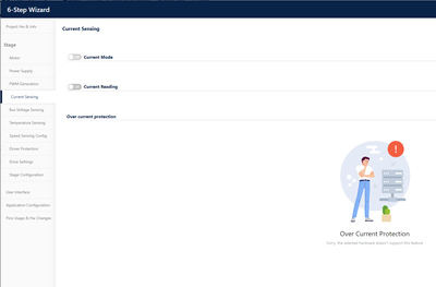

In that case, I am trying to think why my 6-Step design is causing the Over Current fault.
I have limited my power supply to just 5A peak and there's no Over Current option is unsupported anyway with my setup: 6-Step + Hall.
