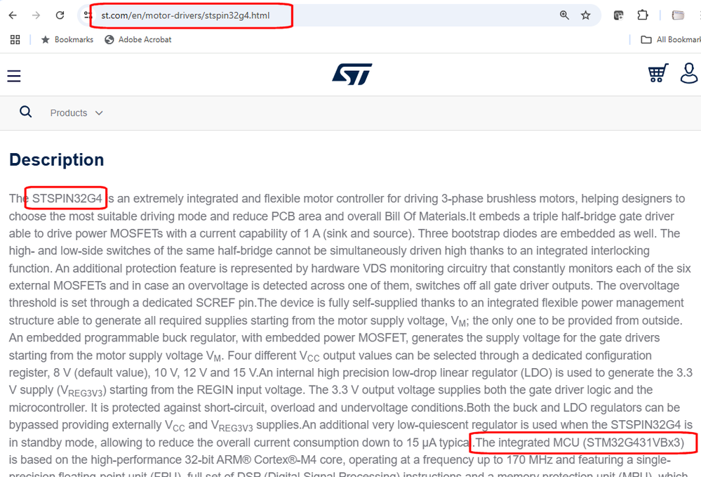

STM32G431VB is the chip on the stspin32g4 board!

2025-04-03 1:45 AM
https://www.st.com/en/motor-drivers/stspin32g4.html
2025-04-03 1:50 AM
Ah, now I understand you. Thank you very much for this hint. I will take a look into the MCU!
