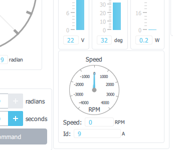

Hi all,
I have profiled the motor using the motor profiler V5.4.8 where the motor was able to achieve 4500RPM, and then created a position control project CMWB V6.2.1. the motor is using 4096CPT incremental encoders as a primary feedback source. With this project I am only able to achieve maximum speeds of 700RPM and nothing more. Can anyone explain why that would be? I am aware that motor pilot can be used to plot graphs and I have been using that to display the current motor position however I'd like to know if it is possible to plot the target position as well?

I have attached the code drive_parameters.h file that I am currently using
2025-03-19 3:23 AM
Hello @msingh08,
Where the 700RPM measure come from? Is-it from an external measure or from Motor Pilot tool?
There is an issue on the ENCODER_SPEED value reported on the High Frequency plot of Motor pilot tool that will be corrected on the next MCSDK release.

2025-04-02 7:11 AM
I am having a similar problem and am looking for a solution. I am using a EVSPIN32G4-DUAL evaluation board and trying to spin a motor in speed mode, and using an encoder to measure the speed. If the speed reference is increased above 700 RPM's, the I_Q increases until an overcurrent fault occurs, see attached.
@GMA it seems that the encoder speed issue may extend beyond just the plotting tool? Could you confirm if there is a fix for this in the next release and when could it be expected?
2025-04-03 12:29 AM - edited 2025-04-03 12:32 AM
In my case I had wrong encoder wiring, which makes me wonder how it operated in the first place. Anyways if you connections are correct, I would suggest looking at your PID loops. It could just be that the speed PID controller is over tuned which doesn't allow you to achieve faster speeds. try increasing the KP in the speed loop.
