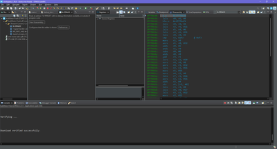

Another strange thing happens when Step over the debug code in the MX_NVIC_Init() function and onto line HAL_NVIC_EnableIRQ(TIM1_BRK_TIM15_IRQn). It causes the code to lockup at address 0x1fff4b30.
However, if I Step-into code, it gets to the while(1) source code (Reside at address 0x80011ee).
