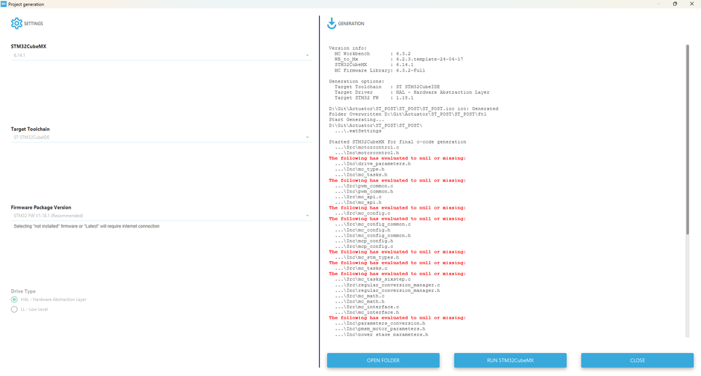

When a project uses a custom inverter with the Six‑Step algorithm and TIM1 selected for PWM generation, the files produced by WB_to_Mx are incomplete:
Expected Result in generated files

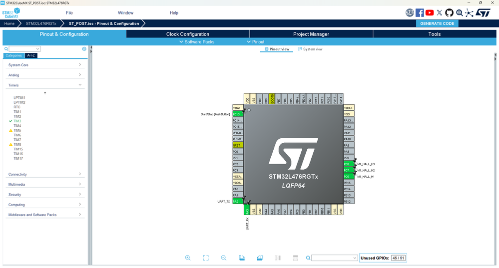

| M1_PWM_TIMER_SELECTION = PWM_TIM1 present in .stwb6 | TIM1 completely absent from .ioc.wb |
| TIM1 channels (CH1/CH2/CH3 + complementary) mapped to PA8/PA9/PA10 and PB13/PB14/PB15 | No GPIO configuration for these pins |
| Mcu.IP=TIM1 entry in .ioc | Missing |
| MX_TIM1_Init() and associated HAL code | Missing |
| Other peripherals (USART2, TIM3 for Hall, DMA, etc.) | Generated correctly |

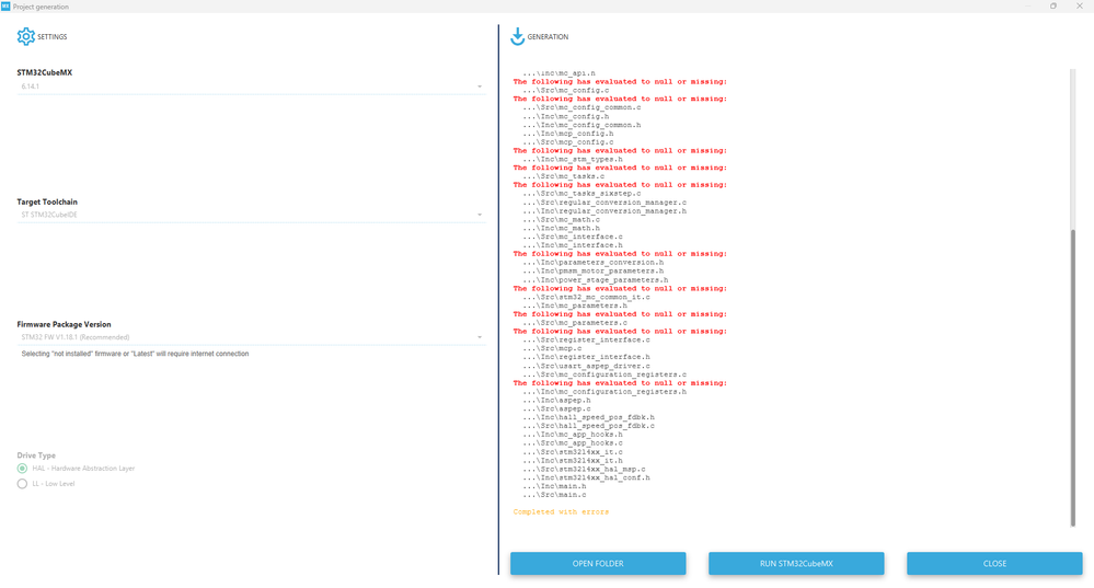

FreeMarker also logs “evaluated to null or missing” errors while creating several header/source files, leaving key parameter macros undefined.
Confirm whether this TIM1 omission is a known bug in MC Workbench v6.3.2 / WB_to_Mx v6.2.3.
Advise if a fix or patch is planned and provide an estimated release date.
If needed, I've attached a ZIP file containing the entire project, including the .wbdef, .ioc.wb, and .stwb6 files
Thanks,
Federico.

Hi FPare.1,
unfortunately, the MCSDK 6.3.2 and next scheduled version do not support such kind of STM32L4 board.
6step algorithm is only supported with STM32G4, STM32G0, STM32F4, STM32F3, STM32F0 and STM32C0 board families.
You pointed out an error into the MCSDK tool allowing the project definition and a non-working code generation of this board configuration for 6step algorithm.
We will modify the next versions of the tool to forbid this.
Sorry for the inconvenient.
Best Regards.
Fabrice

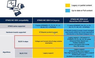

2025-04-23 12:27 AM
Thanks for the clarification.
If possible, please remove the references to the STM32L4 family from the image on this page: https://www.st.com/en/embedded-software/x-cube-mcsdk.html, to avoid further confusion.
Best regards,
Federico.
2025-04-23 2:15 AM
Hello @FPare.1,
On the mentioned ST link, L4 is not listed BLDC 6-steps algorithm compatibility. The first line mentions all supported STM32 series.
