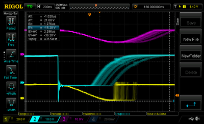

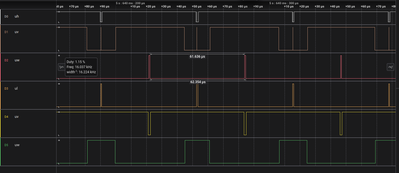

I found that 4 of the pwm signals were swapped around. After changing them to their correct connection I'm running into low voltage faults. But I'll post that on another thread.

Here are some logic analyzer shots of the 6 mosfet PWM pins:
And here is the corresponding scope shot at 16kHz:
I can rotate the motor to get other patterns but it seems like the phases are typically always on together or always off together so no torque is produced.
