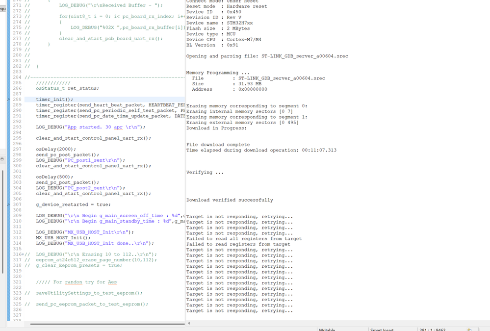

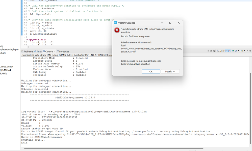

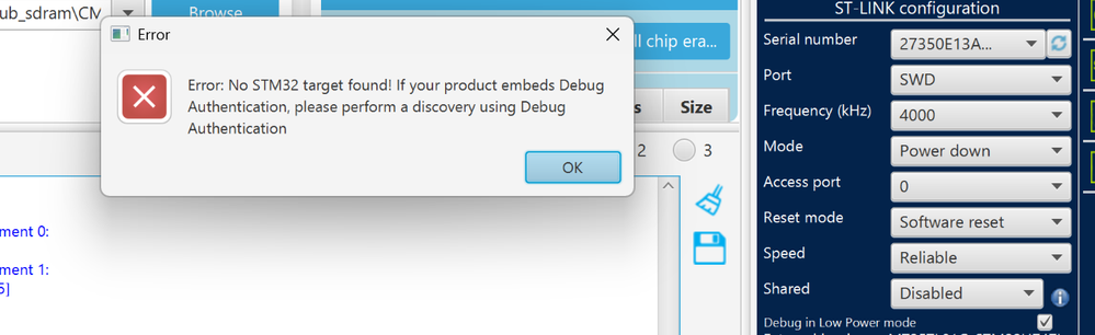

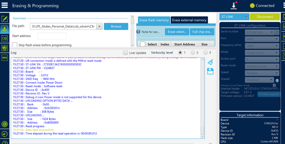

  • Does CubeProgrammer work OK?- Yes using the cube programmer I am able to Flash code but have to set frequency to 1800, while other board works on 4000 (able to debug it)
  • What, exactly, happens when you try to debug? Show error messages, etc ... Have attached the images from cubeprogrammer for both frequencies. on 4000 its not getting detected but getting connected at 1800 as in images

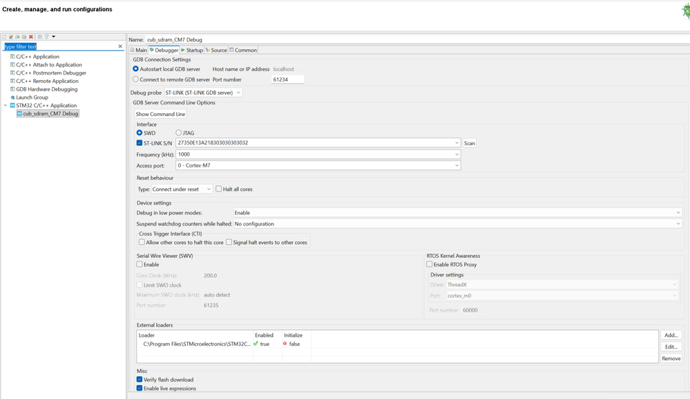

  • Changed the setting in STM CubeIDE in Debug Config set freq to Auto got above.
This is what happening after the code is flashed and after few seconds getting "Target is not responding, retrying"

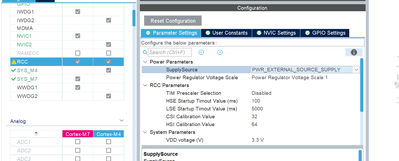

Hello @mƎALLEm
Here is the details
Shiv09_0-1779273998720.pngThough the settings and configuration is notchanged.
Yes both the boards are identical, and same.

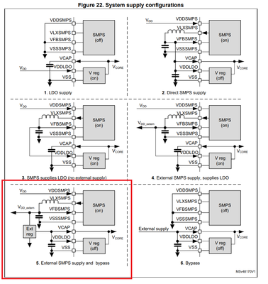

And in your custom board are you having this hardware configuration (from RM0399)?
