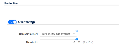

Hello I tried to activate the following function :
But unfortunatly I  have the following error when compiling :
.st_workbench/projects/6_step_config_hall/Src/mc_tasks.c:440:(.text.TSK_SafetyTask_LSON+0xc): undefined reference to `PWMC_GetTurnOnLowSidesAction'

Hi Xavier75, unfortunately, this over voltage configuration does not work into the current 6step implementation. Sorry for the inconvenience of this compilation issue. A correction is scheduled for MCSDK6.4.0 version.
however, the function used to brake the motor if the over voltage error occurs in "turn on low side feature" is the following: PWMC_TurnOnLowSides that switches on the PWN Low Side to generate a brake.
