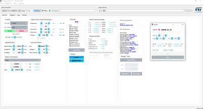

Thanks a lot for the help with the HSO_startup_guide.pdf file. I found this file and tried the workflow on page 9. However - when I click on profiler and start the process I receive an error: ERROR_DC_AC in the profiler window.
I attached a screenshot.
Can you please give me a suggestion what went wrong?
Best regards and many thanks
MoCo

2024-01-24 2:12 AM
Hello all,
This is a really strange behavior. Could you please switch to Open Loop Mode and see if any current is coming through ?
Also could you send me your .stwb6 project files ?
2024-01-24 2:25 AM
Hello again,
You can also try to disable the SCREF feature by adding a jumper to J1 on the STEVAL-LVLP01 power board. This is a voltage protection between the source and drain and it can cause the Profiler Error you are facing.
2024-01-24 6:00 AM
Thanks a lot it worked!
Adding the jumper for SCREF worked. I also had to increase the allowed current in the MCW.
Best regards
MoCo

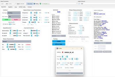

I also have this problem, but I didn't use STEVAL-LVLP01 . I designed a custom inverter, based on G473VE, external amplifier and compare, use TIM8 to generate PWM wave, use IR2101S to drive MOSFET. When I try to profile the motor(based on HSO), I get the error: ERROR_AC_DC.
I have upload the screenshot(90e0d582f6e2fb5d5043ff325aab241.png), stwb6 file(MCV1_HSO_PROFILE.rar) and schematic files(MC_V1.pdf). Could you help me please? Thanks a lot!
