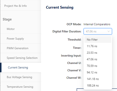

How did you measure the 46A current value? The most accurate is to measure with a scope the voltage at Rshunt point.
Signal could be noisy; could you try by increasing the Digital Filter Duration?
