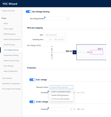

Hello @EDokm,
Dissipative Brake feature for Over Voltage management is available on EVLSERVO1 or STEVAL-IHM023V3 boards and selected in:
2025-04-22 12:33 AM
Hello @EDokm,
