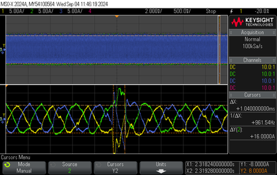

There are two problems. The first is that the phase currents are not as neat and harmonic as I might wish, the second (and main problem) is that once in a while every 10 seconds or so I see this iregularity:
The three phase currents:
I am uncertain of how I shall debug this, I suspect it has something to do with the current sensing. I would like to dump the raw current measurements from the ADC, but I do not think the chip is fast enough to do so.
I have tried to filter the current sensing circuit, but without any luck and without a way of quantifying the noise it is hard to compare.
How would you go about debugging this?

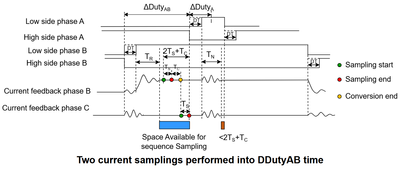

I have read the doc about current sampling in the Motor Control SDK (Current sampling in three-shunt topology using one A/D converter), but have a hard time analysing wether the sampling timing is ok.

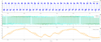

Ch1: DMA1_Ch1_IRQ (called after the ADC and DMA finishes)
CH2-4: Phase voltages
*OBS: please ignore the noise on ch1 it is due to a quick measurement setup
I also did a measurement with a current probe (I only have a 4-channel oscilloscope)
What can you make out of this?

Your total estimated sampling time can be found in the code file parameters_conversion.h, it is named TW_BEFORE_R3_1. It is equal to the latency between ADC triggering and sampling, plus twice your ADC sampling time (sampling 2 phases on 1 ADC), plus the conversion time (between sampling 1 & 2). When looking at your graphs, if you see that the end of the conversion (pin toggling) minus that total sampling time is putting you to an instant where actual currents are still unstable from the PWM switching (you can first look how close to the Phase Voltages switching you are), then you probably need to increase your dead time.
Also, it might be interesting to see whether you have a recurring pattern for your current instabilities. As you may know from the User Manual you were referring to, the sampling instant is not always the same depending on the modulation level. Maybe your instabilities occur only during a specific case with a bad sampling or maybe two cases are switching from one another in rapid succession which could explain the behaviour. Looking at your Ialpha Ibeta in XY graph can also help you look at this kind of behaviour.

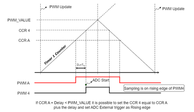

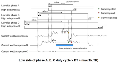

When reading MC_SDK/Documentation/docs_2current__sensing__3shunt__1_a_d_c the sampling in most cases takes place at the low side of the phases.
except for when there is not space in the low side of phases and it is done just prior.
I have a hard time matching the sampling theory with the measurements I have made. These three measurements are representative for most samplings. But all off the measurements show that the sampling crosses a phase edge, which as I understand it it shouldn't (based on the documentation).

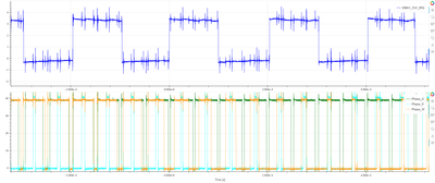

Ch1: DMA1_Ch1_ISR (ADC sampling finished and transfered to memory)
Ch2-4: Phase voltages
PWM: 20kHz
What do you make of these?

Currently, the implementation of the current sampling does not correspond exactly to the theory depicted in the User Manual, which could explain the discontinuities between the UM and the actual sampling window. This has been done for space and speed issue, but may be changed in ulterior versions of the MCSDK. Also, keep in mind that your Pin is toggled after DMA transfer, which effectively happens after a second conversion of the ADC, plus DMA transfer, so your real sampling windows will be slightly shifted to the left. Their length is correct though. This means your third sampling case is probably happening before the switching and not during.
On a more pragmatic point of view, please try to find a way to check if the current instabilities happen in a specific sampling case. Also, have you tried increasing the dead time to ensure sampling during a suitable window ?
