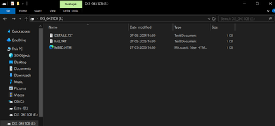

I am using the B-G431B-ESC1 board, which connects to my laptop via a micro-USB to USB-A cable. After a failed connection attempt, the board is no longer detected by STM32CubeProgrammer. Additionally, a file named "File.txt" is created on the MCU after the failed attempt.
The contents of the file are:
"The interface firmware FAILED to reset/halt the target MCU."
This file appears to be causing issues with the connection to STM32CubeProgrammer.

it is FAIL.TXT not File.txt

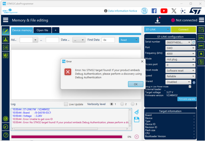

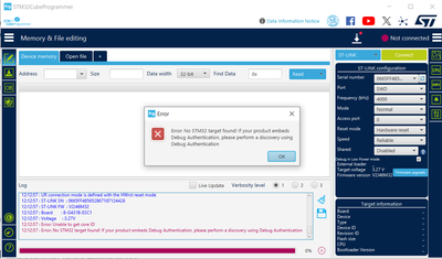

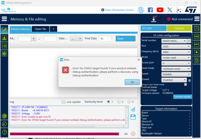

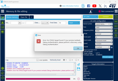

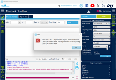

Ans: I've used this method but not working. I've used different combinations of "Mode" as well as "Reset Mode" as shown below in attached pic with different frequency, But still I'm getting same error?

This same issue occurs around 4 months ago, but that time somehow "FAIL.TXT" file removed from MCU, then the STM32CubeIDE as well as STM32CubeProgrammer starts connecting with MCU.
This same issue occurs this time, but now considering previous situation, it is clear that we have to remove that "FAIL.TXT" file.
Note: This is my understanding right now, If I'm not doing right approach then Please tell me.
