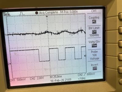

2026-02-17 12:57 PM
Hi Muthanna,
I’ve spun the motor manually and observed the back-emf and encoder values for hall A/motor U (since the motor profiler tool is not working as of yet). Unfortunately, I couldn’t get a super clear measurement since the motor inductance is very small. From my understanding the encoder electrical angle is 0.
Nonetheless, after applying these changes, startup is still failing.
